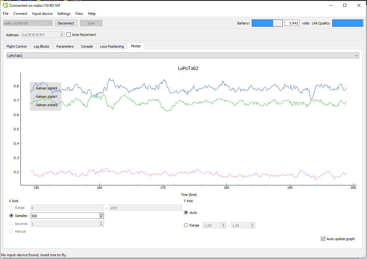

Ah, I see! I've taken a look at the State.Z log (which is under the LoPoTab2, I assume) and took a screenshot of it. I've attached the photo here. My LPS nodes are currently a little above the ground (around 20cm) if that means anything.

So currently the crazyflie thinks it is already 20 cms of the ground. Currently, the motion commander gives a default command to take off at 30 cm, which is only 10 cm higher. So what will happen, is that the crazyflie will only try to go up about 10 cms. Since the LPS system also have cm accuracy, this estimate can differ about 5-10 cm in the z direction. The other crazyflie probably already think that the have already reached 30 cm and therefore will not take the effort to take off. So there are two ways to fix this:
  • Give it an higher z setpoint, either with commander setpoint or with MotionCommander(scf, default_height=0.8) as mc: 0.8 is to replace the default of 0.3)
Let us know if this works

That seems to have fixed the problem with the motion controller. Thanks!
