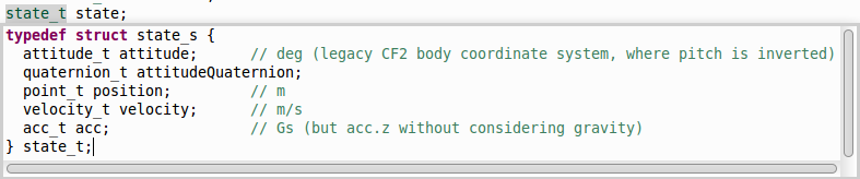

So, I have to extract the Tag position if i wanna get that distance. Then my next question is that How to get the Tag position!
After I've got your reply, i tried to find Tag position. But it's not easy.
I guess,i can't assure, that state.positionin struct state_s is the estimated Tag position. The followings are information about it.
crazyflie-firmware/src/modules/src/stabilizer.c
I really hope that i can get Tag position and make my project to be succeeded.
