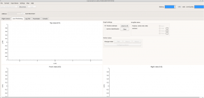

I recently obtainted a couple of CF's with lps decks, a PA antenna and 4 lps nodes. I had a great time flying the drones around with a controller, but now i am looking into flying autonomously with the locopositioning system. However: When i launch the client from the Bitcraze VM the lps tab doenst look the same as any image i can find online. i have attached a screenshot so you know what im looking at.
When trying to update the anchor positions i get the following endless stream of PyQT errors in my console:
AttributeError: 'Nonetype' object has no attribute 'parentItem'.
I have confirmed that my nodes are working as putting them in tag mode yields an accurate distance reading.
I have also tried to manually code a script that updates the nodes position using a cf as a bridge with the lps example. I do not get any errors running the code, but when i look at the TOC of the CF all the anchor positions are still at 0.

I've found this thread that explains a solution for my UI fix: viewtopic.php?f=5&t=2812#p14010
Turns out i have been using the old VM that still had a git bug.

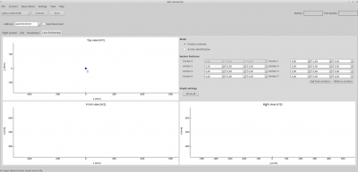

Everything is updated now! :D
However, i stil have an issue where i cannot see my anchors in the client.
Does anyone have an idea what the issue could be?

Turns out that the "default" radio mode (bitrate and preamble) are not the modes that get flashed onto the nodes.
After setting these to default i got accurate localisation!
