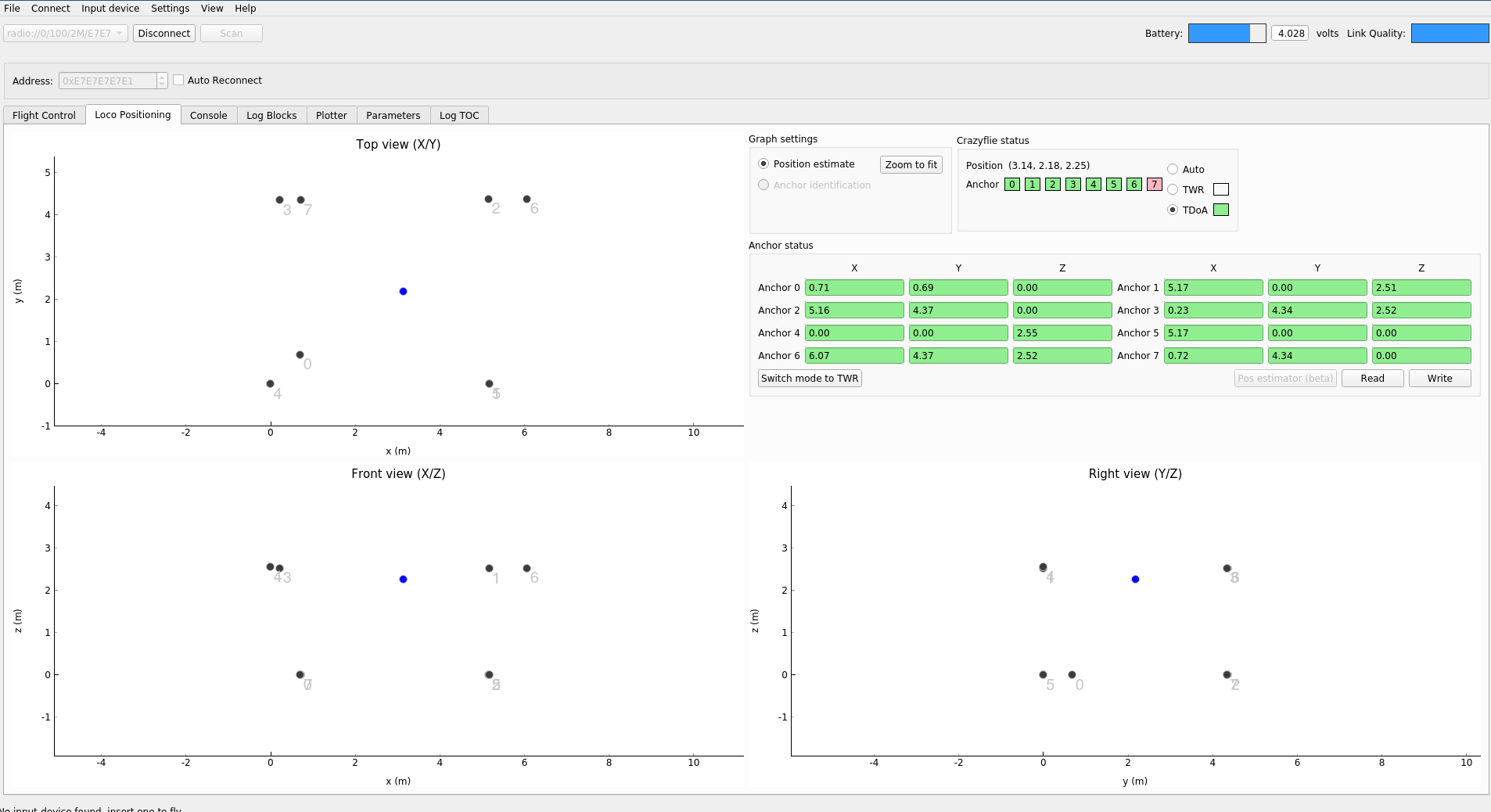

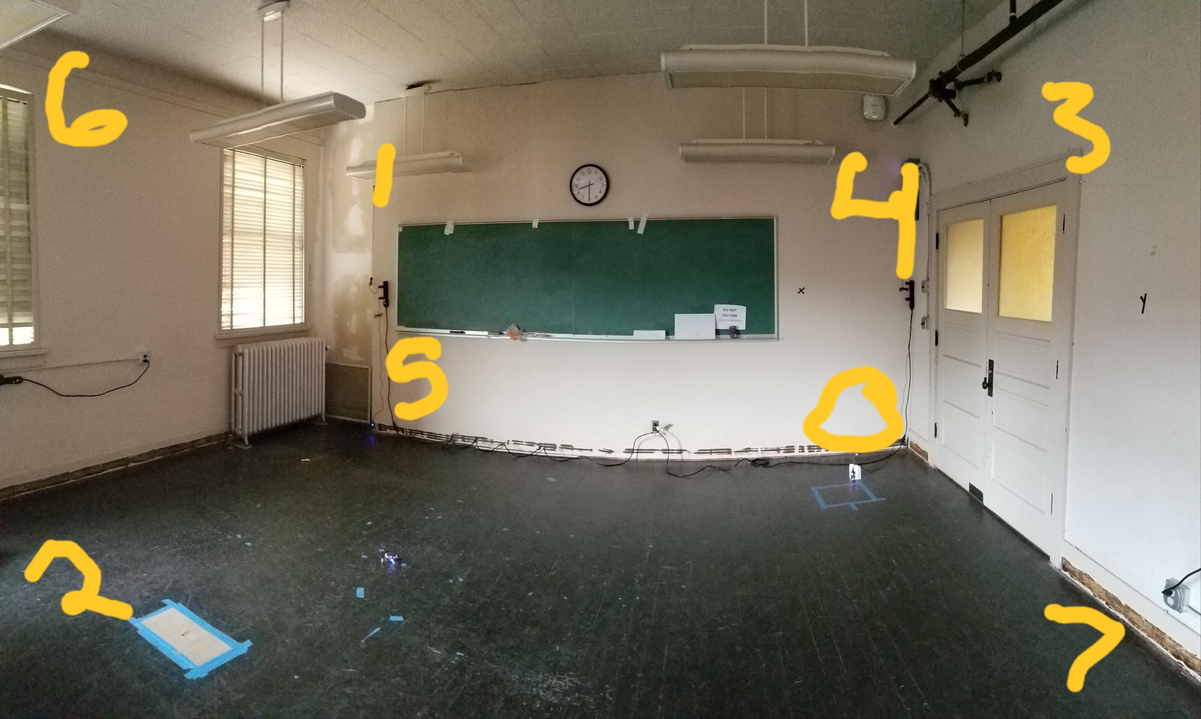

Yes, it is definitely working better now. When I move it to different positions in the room, it does seem to find it's lock. Now it seems, though that flight is unstable. I'm not sure if this is still the z-axis issue or not. It seems like the CF takes off and then hits its setpoint, stops, but then thinks it's still at that altitude. I have noticed that as it flies towards the center, it seems to lose the z-axis lock and cuts motors which causes instability. Below is an image of the room configuration and I linked a youtube playlist of takeoffs from various positions in the room that show this behaviour.

In your second video there is a screen shot of the client and it looks as the Crazyflie does not get packets from all the anchors (three of the small boxes at the top right are red). This is most likely why the kalman filter has a hard time finding the position, it simply does not get enough data.
The first step to solve this type of problem is usually to check anchor placements. In your case I think it looks fairly good, maybe try to move the anchors up 10-15 cm from the floor. On the other hand it looks like a wooden floor and it should not have a strong impact on the radio propagation.
The second option to try is to increase the transmit power of the UWB radios. You can use the https://github.com/bitcraze/lps-node-fi ... x_power.py script to modify the power settings. The settings are transmitted to the anchors using the Crazyflie as a bridge, move the Crazyflie close to all the anchors while running the script. When the settings has been received by an anchor it will reset automatically, so this is a good indication that the update is successful. Just watch the blinking of the LEDs until they all blink the same way as when pressing the reset button. This solution is not stellar and sometimes it takes a while for a successful reception. (There should really be a way to configure this via the USB serial port but we have not got around to implement it)
