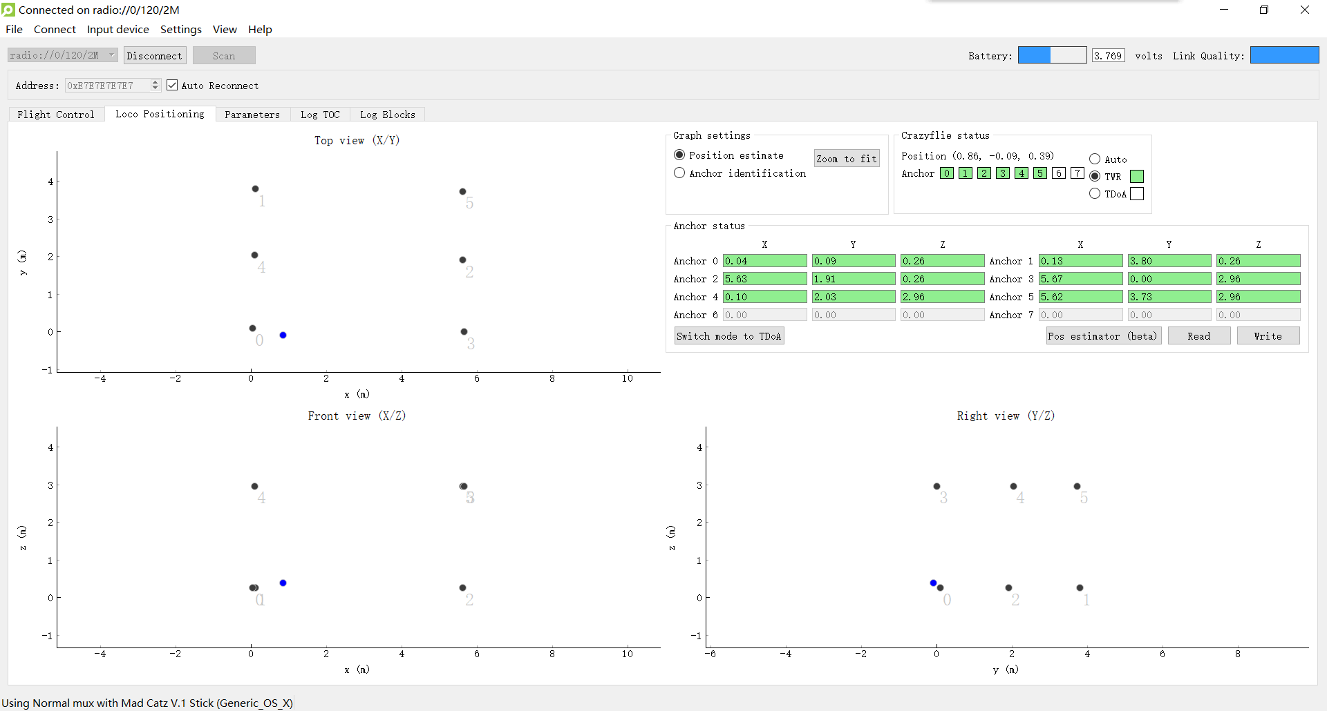

We use a joystick to control the drone by cfclient. The firmware downloaded to the drone is in VM2018.01 with forced DWM1000deck support and TWR ranging support. The location of the drone can be shown in the client correctly as the picture shows though the response is a bit delayed. We tested in anchor identification mode and every anchor can be detected when the drone is nearby. However, when choosing position hold mode in flight control tab and flying the drone with a joystick, the drone drifts.

The ranging mode is TWR and the 6 anchors are placed as the picture shown in lps wiki. The distance between each two anchors is larger than two meters. Before the flight, the target and actual pitch and roll trim are perfectly calibrated.

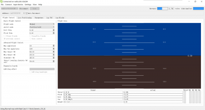

Thanks for your reply, tobias. We will try to use python script or ROS to control the position of the plane later. However the screenshot of the client above shows the target pitch and roll are exactly zero. Doesn't that mean the inputs are zero?
