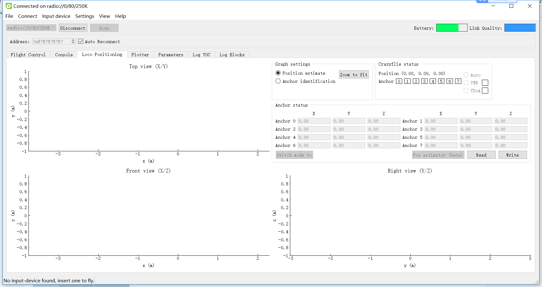

hi,
we try to update the loco anchor and cf2 to newest code, but find cfclient don't any respone,
we have alreadly force the range mode with twr, console info as following:

we see the dwm100deck led toggle ok, 6 anchors led toggle also ok, but the cfclient still gray,

What is the state of your system? what firmware verison are you using in lps node and Crazyflie and what hardware are you using (stock or self-made?). What client version are you using?
One possibility is that the tab is checking the LPS deck one wire memory VID/PID in order to enable itself, you can easily find the code for it in the lps tab. If you do not have a programmed one wire memory, the tab will not be enabled. Ideally we should use the parameter that indicates that the LPS deck driver is started instead (pull request is welcome :-).

crazyflie with dwm1000deck force to support dwm1000 with twr mode, according to the dwm1000deck led toggle, range successfully with anchor 0~5.
we use the VM201801 version firmware. crazyflie stock, dwm1000deck self-made.
201801 release version.
lps deck is dwm1000deck? must add one wire memory? we design the dwm1000board, but remove the one memory.

If you do not want to mount and program a OW memory you can hardcode this variable to 'True' in the client: https://github.com/bitcraze/crazyflie-c ... #L662-L663. As I said, in the future it might be better to test the parameters if the LPS has been started instead of testing the memory.

you are right, thanks!

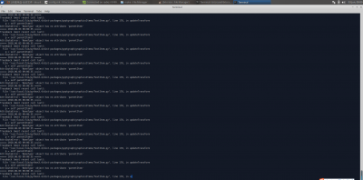

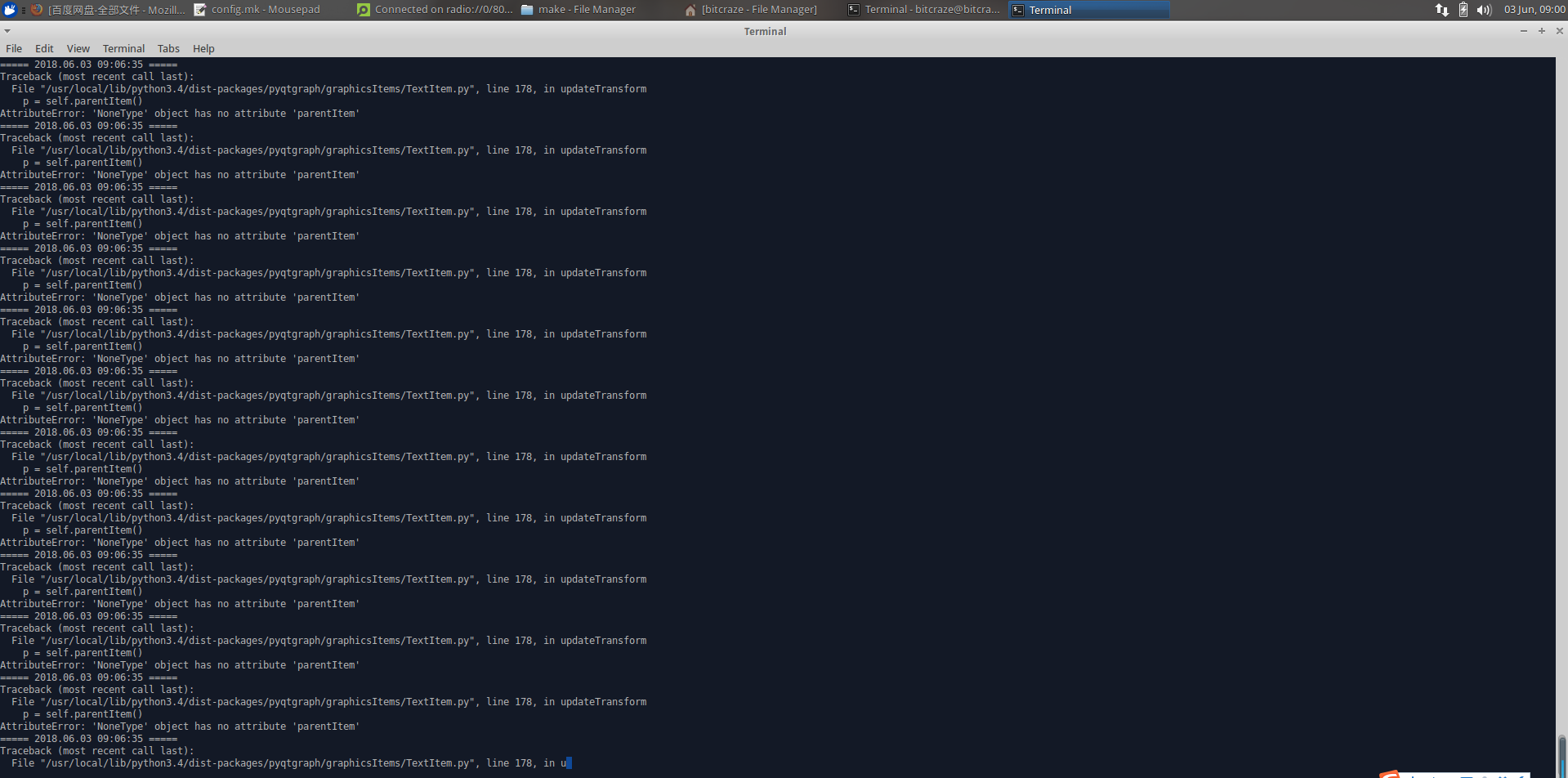

another issue, open Tab Filght Control and Console, cfclient run ok, but when open the tab Loco Positioning, the cfclient run very slowly. the console report infomation:
Posts: 2202
Re: test loco position but cfclient no any response
Post by arnaud » Mon Jun 04, 2018 10:42 am
What version of the VM are you using? It seems to be a problem with pyqtgraph. You could try to re-install it from pip with a series of command like:
sudo apt-get remove python3-pyqtgraph
pip3 uninstall pyqtgraph
pip3 install pyqtgraph
justinleeyang
Posts: 179
Joined: Mon Dec 28, 2015 5:07 am
Post by justinleeyang » Mon Jun 04, 2018 11:19 am
VM2018.1.03
Posts: 2202
Post by arnaud » Mon Jun 04, 2018 11:40 am
Have you tried to remove and re-install pyqtgraph?
