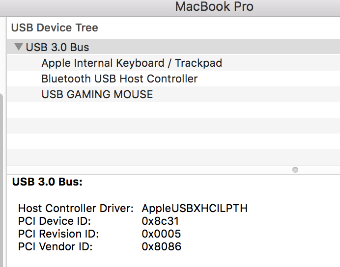

When you plug the anchor while pressing the DFU button, can you see the anchors appear as an STM32 dfu bootloader in the system report? (it should look similar as on these screenshot but with stm dfu: https://wiki.bitcraze.io/projects:crazy ... l#mac_os_x)

As for USB Its not listed in the system report. (USB 3.0 just shows Bluetooth controller, Apple Internal KB and Gaming Mouse.)
