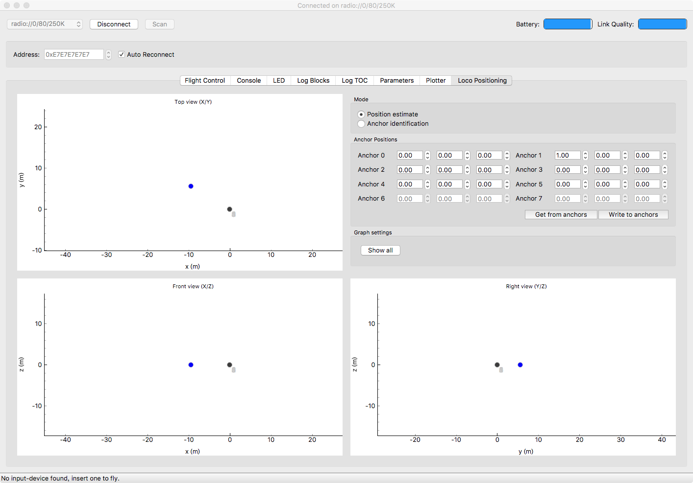

After setting 6 anchor, I was trying set the anchor positions
But each time I change location value and click write to anchors button, nothing changed, and when I click Get from anchors button, value reset to all (0, 0, 0)
Then I trying to set position through python lib and the LoPoAnchor's set_position func stuck

Are you using the latest version (from master branch) of both the Crazyflie firmware and the lps-node firmware? This functionality is still in development (it is being finished this week) and it works with the very latest firmwares.

Thanks Arnuad! It works now, after reflashing Crazyflie firmware
