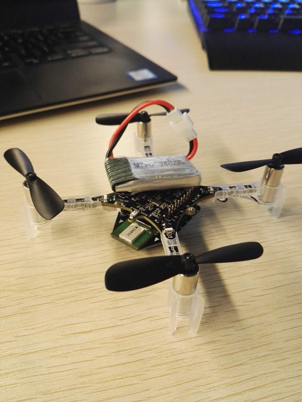

1. Place UWB deck at the bottom of crazyflie, otherwise it affects tele radio.
I was placing it at drone top. It frequently met connection problem, that radio cannot connect to drone in the client software.

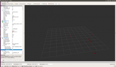

4. cannot found drone position after launch "lps_node"
I launch lps_node by,
roslaunch bitcraze_lps_estimator dwm_loc_ekf_hover.launch uri:=radio://0/80/250K x:=3 y:=2.3 z:=1.0
But there is only three red dots and one axes in rviz,
I checked rostopic, both "/crazyflie/anchor_makers and /crazyflie/marker are empty.

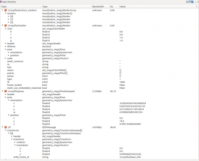

4. For the anchors, in your previous screenshot it seems that it was working, what did you change between the two screenshot and is there any error displayed in the console when starting the launchfile? There is only 3 anchors displayed which might come from the anchor position configuration file. The axis displayed is the setpoint position but the axis representing the Crazyflie position is not in view. I looked at the rosbag you sent on the side and the Crazyflie position is at 9meter by 10 meter (topic /crazyflie/crazyflie_position). This means that the Kalman filter has diverged and is not locking on a position.
Setting the position of the anchor in the Crazyflie could help: https://github.com/bitcraze/crazyflie-f ... .c#L92-L99. Also the fact that only 3 anchors are displayed could be causing the problem (if all the other anchrors are set at 0,0,0 for example).

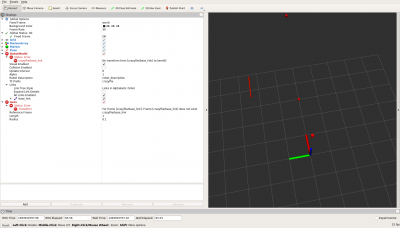

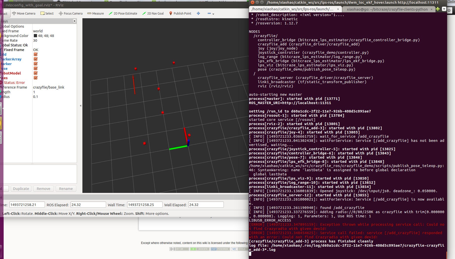

Everytime I launch the lps-ros file, there are error showed in Rviz,
It looks like "crazyflie/base_link" is missing. I'm not sure where goes wrong.
The 3 anchor is because I changed "anchor_position.yaml" file. Now I changed it back to 6 anchors as follow,

I launched the file,
There is crazyflie position update but the position is so random and I still didn't find why.

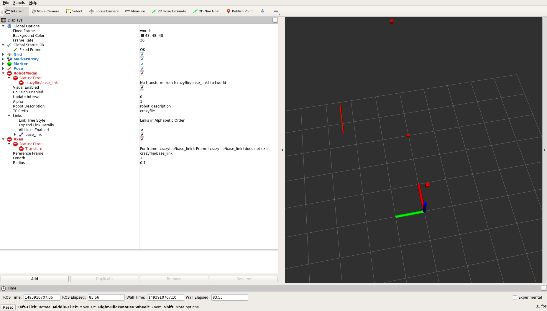

I have a basic idea where goes wrong with error i)
There isn't /crazyflie/base_link frame. So, there is error in RobotModel and Axes.
But I still didn't know how to create /crazyflie/base_link.
Re: Running loco positioning problems
/crazyflie/base_link should be broadcasted by the ekf_bridge node: https://github.com/bitcraze/lps-ros/blo ... py#L34-L41
Maybe this node is not launched successfully?
