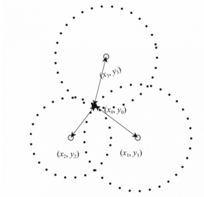

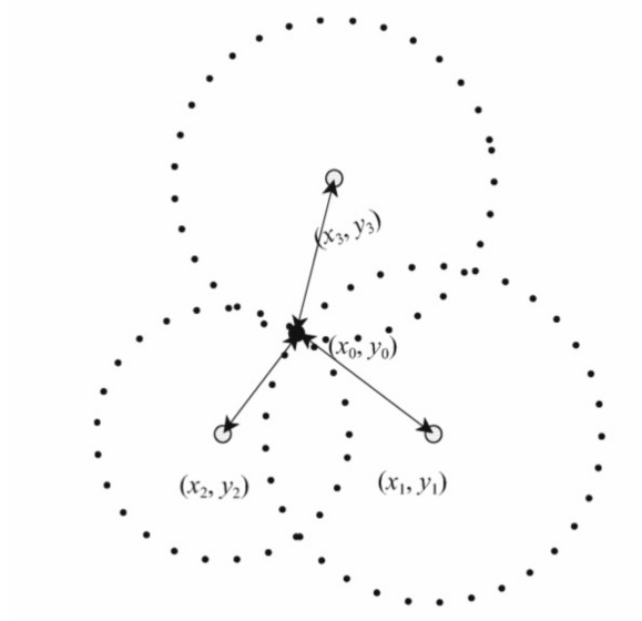

hi, arnaud:
yeah, because we know that get the 3D position (x,y,z), must more than 4 anchors, if we use TOF method, we need know the tag and 4 anchors distances. the following figure is 3 anchors position method to get the 2D position (x,y), likely, add a anchor, we get the 3D position (x,y,z) . But we need the 2D or 3D Algorithm to calculate the (x,y,z) with all distances and anchor's known coordinates. from the stm32 code, I don't see the algorithm, so ROS implement the algorithm ? the above is TOF method.
likely, if use TDOA estimator the 3D position with time difference and anchor's known coordinates, we also need other algorithm to get tag's coordinate. but from estimator_kalman.c, I don't find other algorithm other than kalman. I miss something ? or my understand wrong ?
Re: about estimator_kalman.c
The kalman filter is updated with information from the LPS by this code: https://github.com/bitcraze/crazyflie-f ... #L880-L937. There is two function, one for TOA and one for TDOA.
I am not completely versed with this code yet but my understanding of it is that both the error and the direction of the error is pushed which allows to close-in on a position estimate (I know that this intuitive interpretation is somewhat wrong so if someone want to correct me please do .
