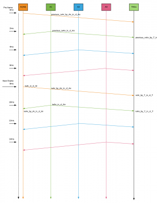

- Posts: 186
- Joined: Mon Dec 28, 2015 5:07 am
Re: about TDOA
hi, arnaud:
according to my understand TDOA code, if only use 4 anchors and a tag, I draw the processing, and mark the paramter, right ?
Re: about TDOA
Hi Justin,
Your drawing looks correct.
Currently the TDoA algorithm we are using is not using a single anchor as master. When the Crazyflie receive a sequence of packet, for example A0 then A1, A0 will be the reference (Ar) and A1 will be An in the equations. When then receiving A2, A1 becomes the reference Ar and A2 becomes An. That way we can synchronize one anchor to its closest neighbor time-wise.
Then your drawing is correct for anchors A0-A1. If we consider A0==Ar and A1==An, the timestamps are used to:
- Calculate the clock skew of An versus Ar
- Calculate the distance, in time of flight, between Ar and An, expressed in Ar clock.
- Calculate the tag clock skew versus Ar
- Calculate the difference of time between the latest transmission time of Ar and An expressed in Ar clock versus the difference of reception time by the tag expressed in Ar clock.
Doing so we get the difference of time of flight of the two packets, and we can feed the distance difference in the Kalman Filter.
