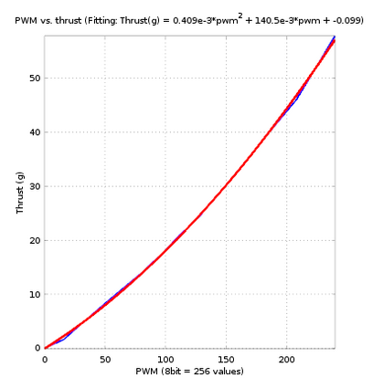

Hi, I have another question. For the pwm vs thrust plot that your provided(see attached picture), is this relation between single motor's pwm value and single thrust? or it is the relation between mean of four pwm values and total thrust?tobias wrote: ↑Tue Aug 10, 2021 9:32 amThe thrust value is translated to a PWM signal which is driving the motors and has a linear relationship to the thrust if supply voltage would stay the same. However the battery voltage, doe to internal resistance, doesn't. You should look at the PWM vs Thust graph.My first question is the percentage of stabilizer.thrust is based on what kind of relation, is it the rpm vs thrust?

What's more, for above plot, the x-axis is 8-bit=256 values PWM, but the logging parameters pwm.m1_pwm to pwm.m4_pwm is 16-bit=65536 values PWM. Should I map the 16-bit values to 8-bit values if I want to use your provided thrust transfer function?

It is the relation between same pwm value to four motors and the total thrust.
Yes, 16-bit is mapped to 8 bit.

For your first reply, Why do you add a question mark? do you mean for above plot, the pwm of four motors should be the same and this same pwm is the x-axis of the above plot?the y axis is the total thrust?
The true situation is that the pwm of four motors could be different, what should I do if I want to get the thrust?Could I use the mean of the pwms of four motors?

Yes, the same PWM is sent to all four motors in the test. There will be individual differences for each motor so when calculating for each motor (total trust / 4) you will get the average thrust.do you mean for above plot, the pwm of four motors should be the same and this same pwm is the x-axis of the above plot?the y axis is the total thrust?
