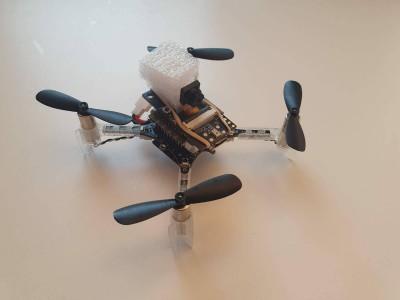

Otherwise we actually have an esp-eye lying around at the office and we just attached it to a Crazyflie. We will test it tomorrow but such a setup would fit your purpose, the esp32 is poweful enough to implement an on-board line follower. The biggest problem is that there was no IOs easily accessible so we had to patch the power and serial port to a Crazyflie battery holder deck using very thin wires (we patched the serial port from resistors on the ESP-eye and the power on the micro-USB connector...). So another esp32 camera board small enough to fit on the crazyflie but with actual testpoint/pins for connection would have been much better.
We have not tried flying with the esp-eye yet, we will likely try tomorrow, I can update this thread with out result (in theory it should fly without problem... :).

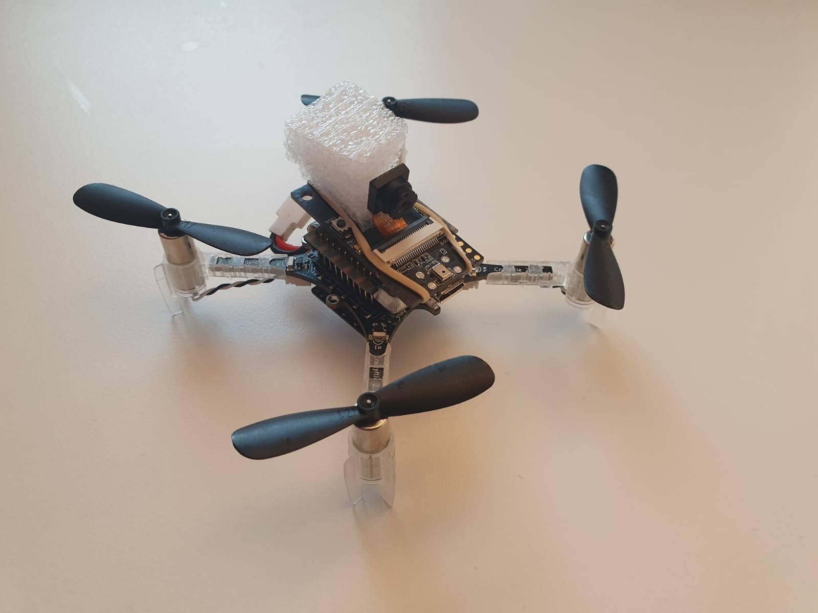

Kimberly flew the Crazyflie with the esp eye on Friday and it does work! The only issue is that the board consumes a lot of energy and so it requires a good well charged battery to be useful at all (we are not sure where the big power draw come from, wifi or camera ...).
The final setup looks like that (in your case you could mount it on the bottom and let the camera face down):
As I noted in my first post though, it would be better to find a board with test-points or pin header since this one was quite challenging to connect to the Crazyflie.
