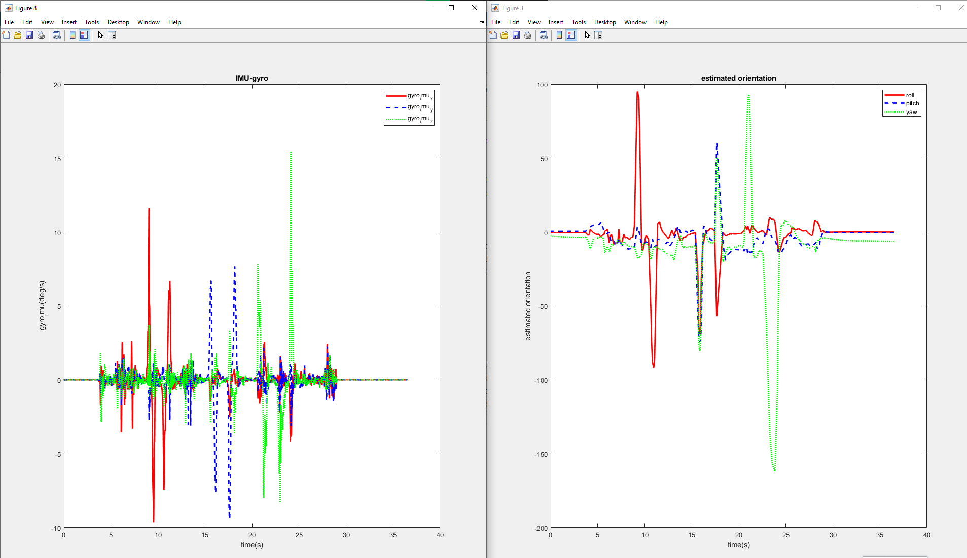

Q3: I have noticed that in your official website, the positive direction of roll and yaw angle are clockwise and the positive direction of pitch angle is counter-clockwise. However, I have done some tests. I hold the crazyflie and move it(Firstly I let crazyflie clockwise rotates along x axis 90 deg and back to 0, then counter-clockwise 90 deg along x axis and back to 0, then I let crazyflie clockwise rotates along y axis 90 deg and back to 0, then counter-clockwise 90 deg along y axis and back to 0, finally I let crazyflie clockwise rotates along z axis 90 deg and back to 0, then counter-clockwise 90 deg along z axis and back to 0). The results is attached in following picture(The estimated orientation is from kalman filter of the crazyflie). It shows that the although the positive direction of pitch angle is counter-clockwise, the positive direction of gyro in the y axis is clockwise, is that true?

Q3. Yes exactly that is correct. You see that here in the code too: Why this is exactly done this way, I wouldn't know myself but I guess it seemed more logical at the time to have positive pitch be pointed up, even though we are using a east north up (ENU) coordinate system, as in the past they didn't want to go for the North east down (NED). But yes from an aerospace convention point of view it is a bit strange.
