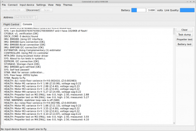

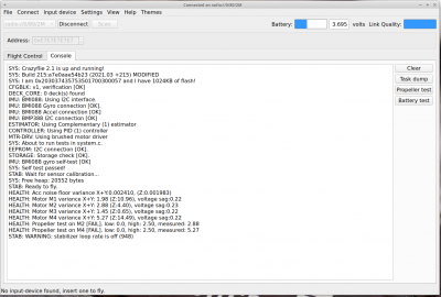

Hello! Thank you for the suggestion! I ran the propellers test twice to make sure that the results are right.
Edit: I'm not sure what to make of these results.
Second Test
Second Test
First Test

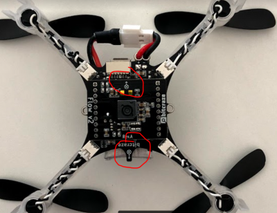

Yes as wydmynd recommended, it is always handy to have a console tab so thanks for that! For in the future, also mention which decks you are attaching to the crazyflie as well! But luckily there was a picture.
So in the console tab, you see the following:
DECK_CORE: 0 decks found
This should state that it found 1 deck if you attached one. But... looking at your picture it can be seen that the flowdeck is attached the wrong way around that you can see with the symbols I've marked here
Here are some instructions to attach the flowdeck properly:

Hello Kimberly! thank you for the reply and for informing that the flow deck is mounted in the wrong direction.

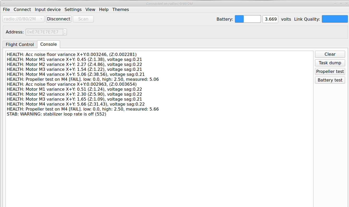

But my issue was with flying the crazyflie 2.1 manually using the crazyflie iOS app. I ran the propellers test again today and looks like there is something off with M4 motor.
My question now is, how can I make sense of the propellers test results? does this mean I have to replace M4 motor?

Also in the video seems to be spinning around the m3 motor, but now the m4 is reporting to have problems. If indeed the propeller balancing didn't work or replacing it with a new one, then the next logical step is to replace the motor. But I'm not really convinced that is the full problem, but it never hurts to try!
