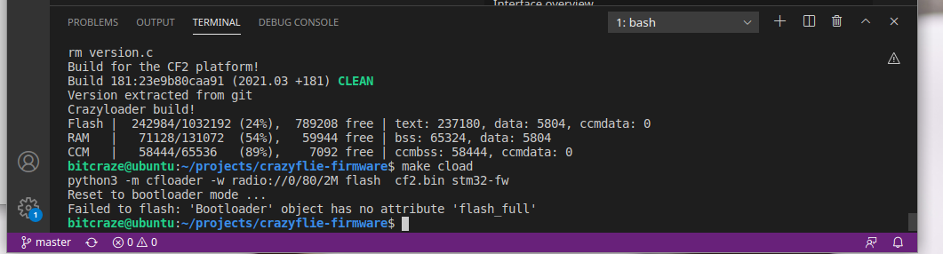

I am trying to follow the documentation with getting started with development. I am getting the following error (as seen in picture below) when trying to cload. I am performing 'make' and 'make cload' in the projects/crazyflie-firmware folder. In addition the crazyflie is in bootloader mode( I make sure to hold power button for 3 seconds until M2 and M3 blink).

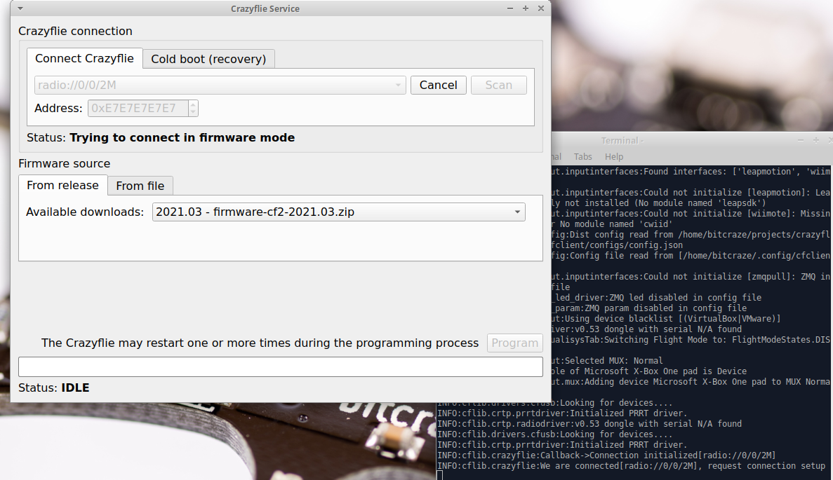

In addition, in the crazyflie client, when I try to use bootloader, I get the message "Trying to connect in firmware mode" and it gets stuck on this message. (See bottom picture)
Any suggestions on things I can try? I believe these issues might be linked.
'flash_full' error when trying to us make cload
Re: 'flash_full' error when trying to us make cload

Lets try to get to the bottom of this! Maybe we could make sure we do not have mismatch between the python library (crazyflie-lib-python) and the client (crazyflie-client-python).
Could you get them both from GitHub and install them from the master branch using pip3 perhaps?
So we can rule out any software tomfoolery!
Thanks
pip3 install -e .
