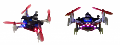

Alternatively, if anyone could pick what props these are, I will chase them down, I found this image on the Bitcraze guest blogger website.
Thanks again!
