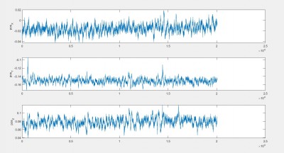

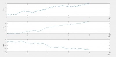

Update:
I added graphs for the pitch/roll/yaw in 3 minutes of time while the drone is in complete stationary. As you guys can see there is an increase in angles with no clear reason especially in "roll" angles.
For the position using LPS with 8 anchors, it looks fine. I have a standard deviation of 0.0079, 0.0067,0.0099 for X,Y,Z respectively
What do you guys think?

It is hard to make it drift little without using some external stabilizer such as the flow deck. How stable to you hope to get it? Minimizing vibrations is something that helps.

The fluctuating values can be expected because of the noise from the positioning, the question is how much. Have you tried flying manually without the LPS, just to check that there is no problem with the CF2. It could also be some miss-configuration of the LPS, the wait_for_position_estimator hints that.

The drift you see is small and comparing it to a CF2 I have here it looks normal. I'm leaning towards that it is something with the scripts or that the joystick is none zero. What script have you tried?
