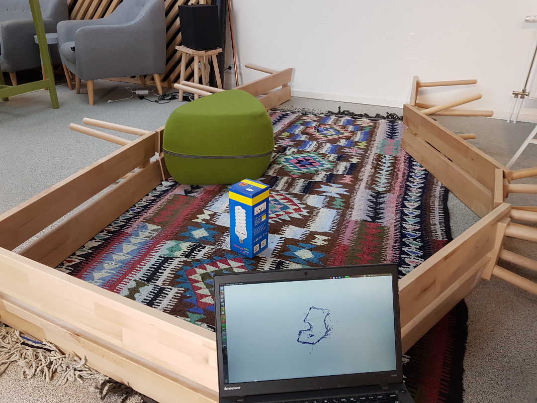

Tried running the multi-ranger and plotting the data. The plot is 3D, but since the flight is at 20cm fixed height it's kind of 2D.

There is no proper method to identify the out of range readings in VL53L1X. When an obstacle is not within the range, sensor gives random values. That's the reason to mark the cells as occupied at unnecessary places.
Are you plotting the points with respect to the height to make a 3D plot?
The biggest problem is the pose correction with a limited number of sensors. Are you using any kind of pose correcting method or just plotting the points around the estimated position from EKF?
marcus
Posts: 599
Re: Tuning PID after adding new decks
Post by marcus » Mon Nov 26, 2018 8:22 pm
Ok, thanks for the info. I haven't looked that much into the limiting but it sounds interesting. For the plot in the image I limited the distance to 2 m.
Yes, it's plotted in 3D but I was at the same height (the boards around wasn't very high). But I'm hoping to get some time trying to fly in an environment where I get go a bit up and down. I've cleaned up the example a bit and posted it here.
I haven't tried any correction, I'm just plotting the points around the estimated position from the EKF.
