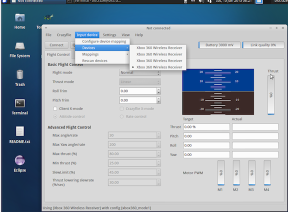

Hello thanks for your post. I went into the terminal and typed what you told me. It just allowed me to type in the commands but there was/is no change in anything. Not sure what it was suppose to do. Here is a capture of me putting in the code

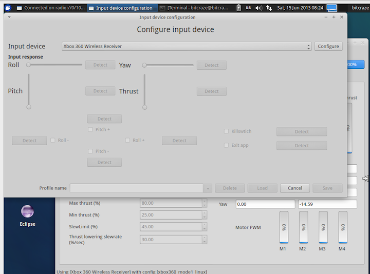

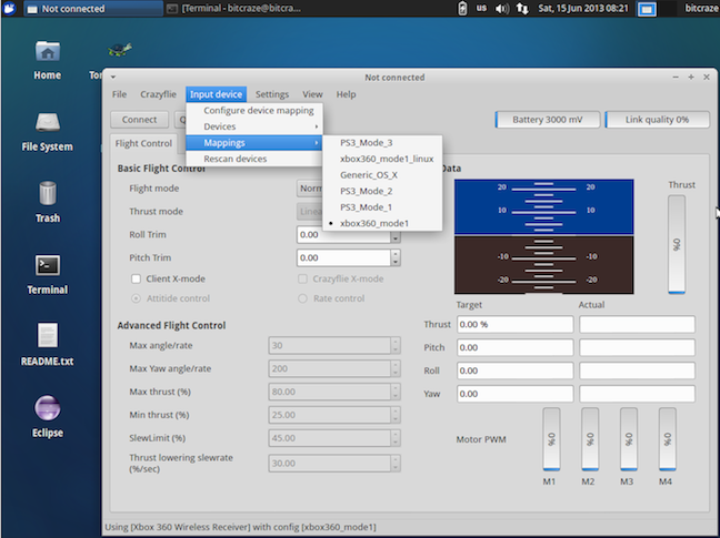

I appreciate everyone stepping in to help. I am also admitting I am very upset as I have spent many hours on this. I understand this is not a toy but it is getting ridiculous and extremely frustrating..
Answers: Yes all four motors rotate
Answer: blue is sold, green is solid but looks like it is receiving information similar to old school computer tower light and the red flashes

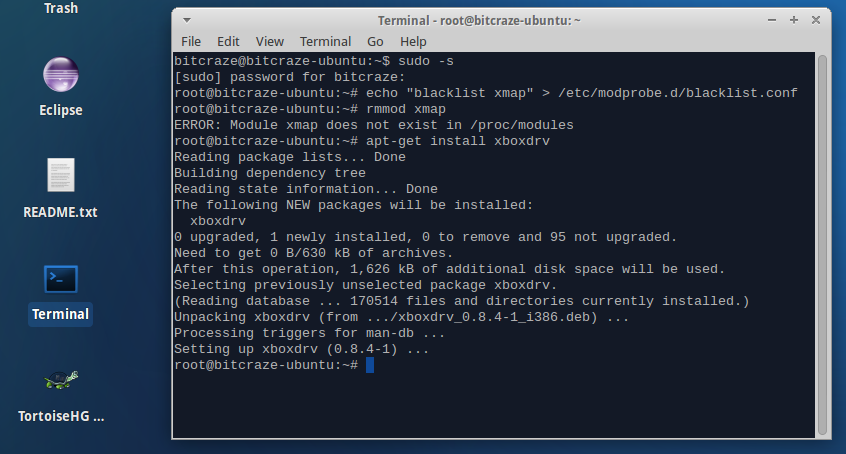

You seem to be running into this problem for which there is a solution here.
I can't test out the steps completely myself right now (my own controller refuses to be recognized by Virtualbox as it is captured by the host system and all USB filters in the world don't seem to prevent that...), I'll try to walk you through the steps. It is important that you do them in the order I line out here, and that you check the command's outputs against the described expected output.
1. First open the Terminal in your VM by double-clicking the terminal icon on the desktop.
2. Enter the command sudo -s and hit Enter. You will be asked for a password, enter crazyflie for that and hit Enter. It should now say "root@bitcraze-ubuntu" at the beginning of your command prompt (it previously said "bitcraze@bitcraze-ubuntu")
3. Enter the command echo "blacklist xmap" > /etc/modprobe.d/blacklist.conf and hit Enter. Nothing visible should happen.
4. Enter the command cat /etc/modprobe.d/blacklist.conf and hit Enter. It should show exactly one line, blacklist xmap
5. Enter the command rmmod xmap and hit Enter. If you do not happen to have your XBox controller plugged in, this might show ERROR: Module xmap does not exist in /proc/modules, which in this case is ok. Otherwise it should show nothing.
6. Enter the command apt-get install xboxdrv and hit Enter. It should probably say something like The following NEW packages will be installed followed by the name xboxdrv in the new line, it might also say something like xboxdrv is already the newest version or maybe something along the lines of xboxdrv now being upgraded. All of these are ok.
Ubuntu Bitcraze [wird ausgeführt] - Oracle VM VirtualBox_2013-06-15_14-32-41.png

Thank you for the steps. Unfortunately I got stuck at step 9. It is not detecting my xbox 360 controller's movements now. I attached a snapshot of where I got stuck. Before it was responsive but since I did the steps 1 through 8 it is not responsive anymore.
