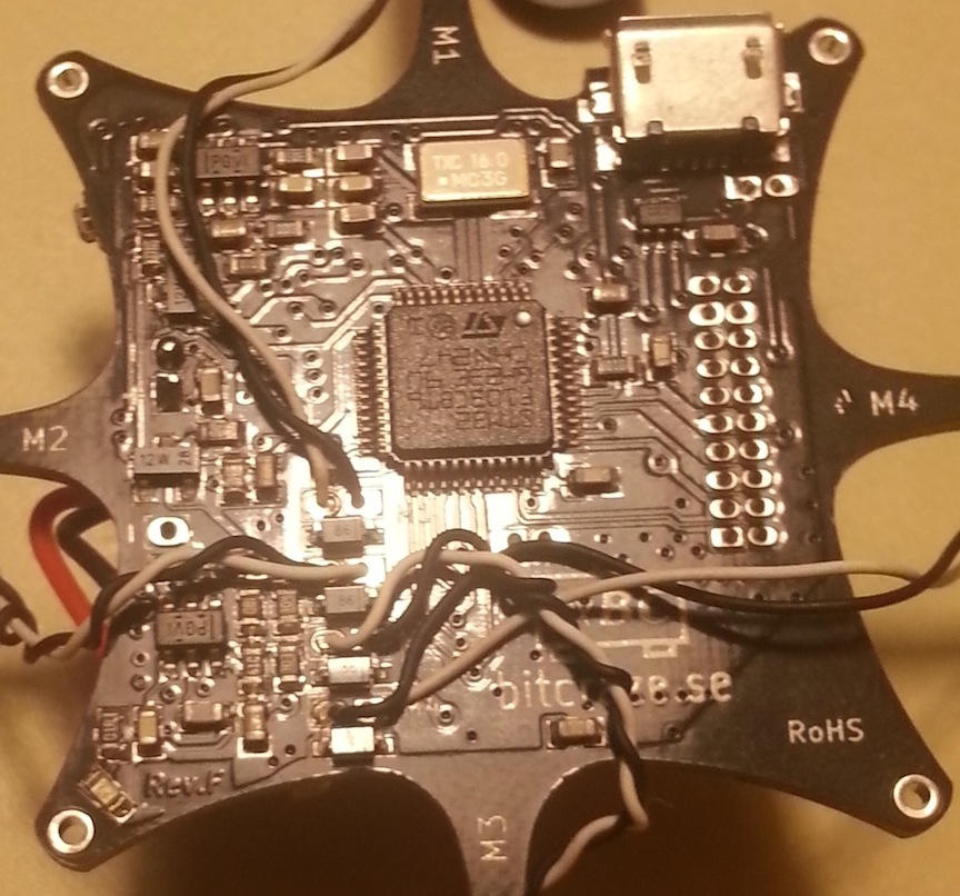

Can you post a picture of your soldering of the motor wires? If you get a response (horizon) from the CF and thrust response from the controller then the issue has something to do with hardware.

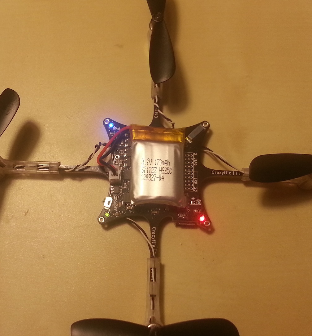

Here is a picture of my dust collecting CF
That side looks good. How about the other side? Can you post a close up of the motor wire connections?

:| That's not a close up picture. I wanted to see if the solder connections of the motor wires (under the battery) were good.
Do the motors spin at all?

atomicdog wrote::| That's not a close up picture. I wanted to see if the solder connections of the motor wires (under the battery) were good.
Sorry I tried my best with my cell phone. Yes all the motors spin and the CF tries to fly when I push my mouse up in the mode (forget what I call, please check previous notes).
