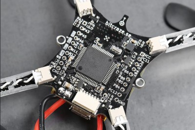

Attached is the backside of my Crazyflie 2.0 as how it is supposed to be assembled.
It looks very much like you have accidentally connected all 4 connectors the wrong way around. The two small plastic taps of the plug attached to the motor needs to face away from the pcb itself. I attached a picture of the correct orientation. This would also explain why all the propellers are spinning the "wrong" direction, as they are being fed backwards.
Try and flip them and see if that doesn't help.
/J

@Jens_Lee
Thank you! You nailed it! That was the whole problem. I would suggest to add a cautionary advice about the correct insertion of the motors here: https://www.bitcraze.io/getting-started ... infostep19
My Crazyflie 2.0 now flies and doesn't spin! However, it doesn't have a clean take off, meaning it doesn't go vertically straight. It takes off with some degrees off. Is there a way to make it lift off straight as if it would be hovering?
Thanks again @Jens_Lee :)
