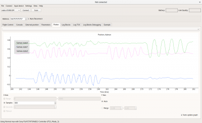

and im using the Client with the external tab. I have build a Stereo-System(2 PS-Eye) to track the copter and the kalman filter is giving me good estimations. (I send the external position-data with 5Hz) . Furthermore i changed the Kalman-Estimator. Now my Questions:
