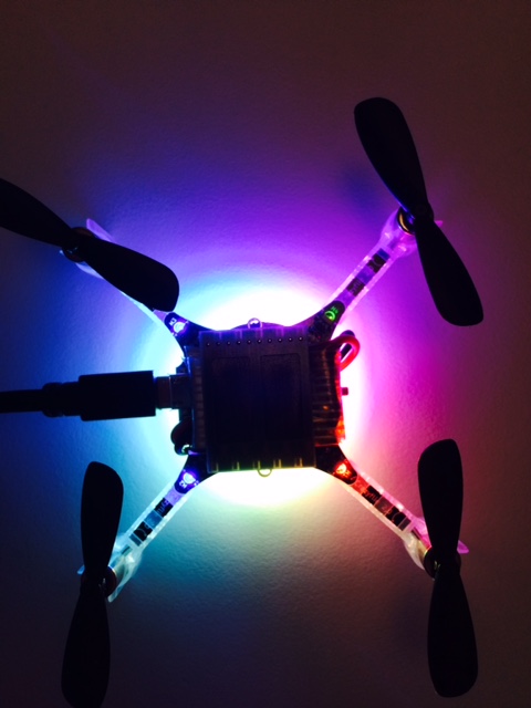

Hi guys !
- FULLCOLOR RING Rotating circle with RAINBOW effect (like photo).
- UNICOLOR ring with Rainbow change effect (like PHILIPS LAMP)
Include a full RGB to HSV transformation function.
If someone is interrested about code source, please told me what i have to upload (FILE > cflie.bin? , neopixelring.c? , full project folder? or copy past of source code ?)
Thanks for your help
... I really love this new toy, it's awesome ! ...so funny !!!
CF2 - NeoPixelRing - Full HD Color Rainbow

Nice effect. Could you post your effect function (the one with signature static void yourEffect(uint8_t buffer[][3], bool reset))?

Really nice effect! It would be great if you wanted to create a pull-request for the code. Otherwise I could merge it in manually if that would be ok, since it's definitely something we would love to have in the firmware.

These effects are awesome!!!
I had to change the first 3 declares and the occorences of them in the effects to make it compile though....
I just added "2" after red green and blue
