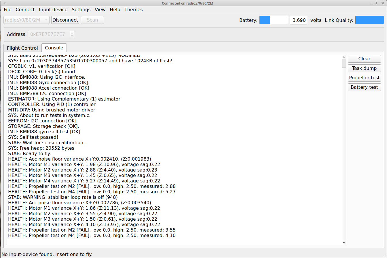

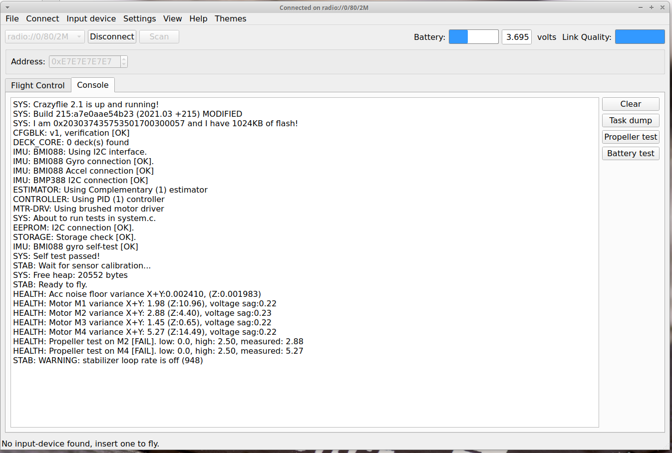

Hello! Thank you for the suggestion! I ran the propellers test twice to make sure that the results are right.
Edit: I'm not sure what to make of these results.

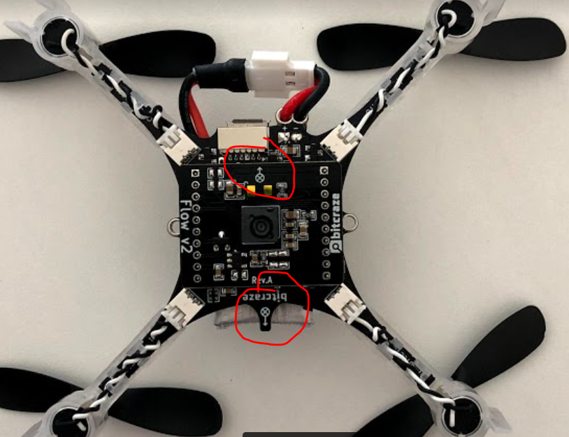

Yes as wydmynd recommended, it is always handy to have a console tab so thanks for that! For in the future, also mention which decks you are attaching to the crazyflie as well! But luckily there was a picture.
So in the console tab, you see the following:
This should state that it found 1 deck if you attached one. But... looking at your picture it can be seen that the flowdeck is attached the wrong way around that you can see with the symbols I've marked here
Here are some instructions to attach the flowdeck properly:
DECK_CORE: 0 decks foundHere are some instructions to attach the flowdeck properly:
Getting started guide with STEM bundle
Getting started with expansion decks

But my issue was with flying the crazyflie 2.1 manually using the crazyflie iOS app. I ran the propellers test again today and looks like there is something off with M4 motor.
My question now is, how can I make sense of the propellers test results? does this mean I have to replace M4 motor?
