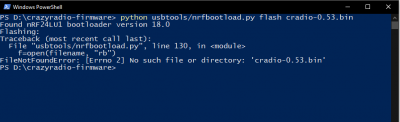

I've been trying to flash the latest version of the Crazyradio firmware using Windows Powershell but I keep getting an error. I've attached the error in this thread.
I was following the instructions from the https://www.bitcraze.io/docs/crazyradio ... ogramming/ and was able to launch into bootloader but I was unable to flash the firmware because of an error. It had worked before but I'm not sure what caused it to stop working.
I've checked my usbtools folder and the "cradio-0.53.bin" file is there so I'm not sure what's going wrong here. Also, is it a normal behavior that the CrazyRadio does not light up when it is plugged in the computer despite not having the firmware installed?
Any point to the correct direction would be great!
Posts: 2089
Re: Unable to Flash Crazyradio
I think the problem is that the "cradio-0.53.bin" needs to be in the folder you are launching python from. If it is in the usbtools folder you should run
python ../usbtools/nrfbootload.py flash usbtools/cradio-0.53.bin
