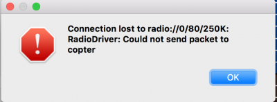

This is the error I get when a disconnection occurs
Posts: 1995
Re: crazyradio disconnect over 1 meter away
Post by tobias » Tue Jun 05, 2018 7:05 am
Try to change the channel en rate to e.g. channel 90 and 2Mbit datarate.

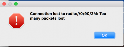

Thanks Tobias for the suggestion. I have tried multiple configurations of channels and data rate and I have the same error message when sitting on my desk and just waiving the cf around me.
-I feel the problem is with the crazyradio but I don't know what other things I can check? any idea? is it possible that the crazyradio is defectuous? is there any other way to test the crazyradio.
